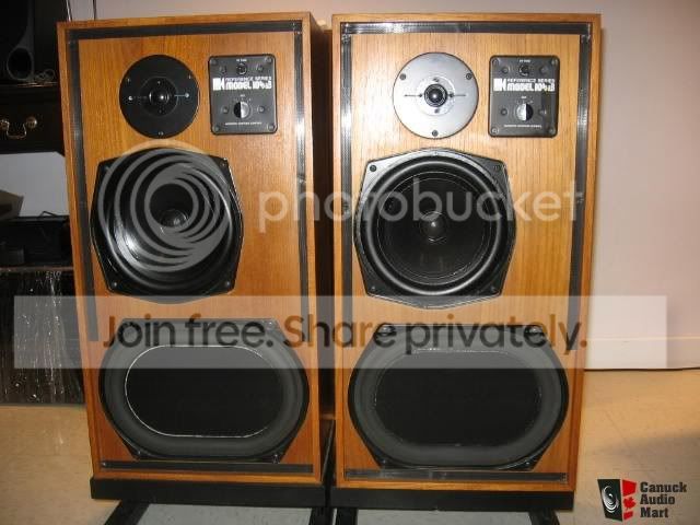

Re the big Kef with oval drivers, those old Kef speakers used a B139 bass driver. There was also a passive unit known as an Auxiliary Bass Driver (ABR) which was effectively a 139 with the motor removed and was driven by pressure changes within the sealed cabinet.
What you have might look something like this classic Kef 104ab:
