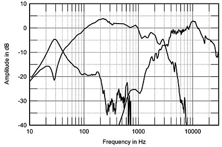

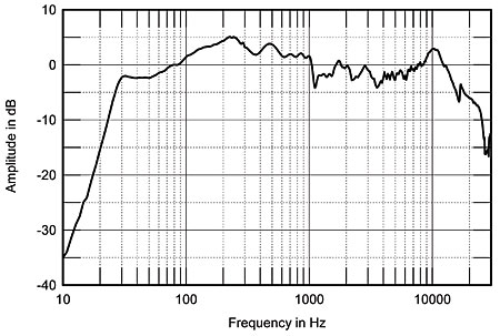

I'd say that there's a 100% chance that a large part of the thinness in the OP's system is down to the speakers.
Here's the Stereophile measured frequency response for the Audio Note AN-E Lexus speakers:
This is the sort of frequency response I'd expect from 8" mid/bass cones in a medium sized ported box.
This is just another example of Hoffman's Iron Law. With the AN's you get small size and medium to highish efficiency with no true bass extension. Thin thin thin.
BTW interesting that Audio Note claimed 98db efficiency whilst Stereophile measured them as 93db efficient.
