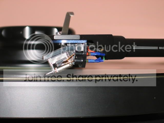

Anyway, I have taken a photo of the cartridge at rest so to speak- I hope it comes out ok.
The turntable is a VPI Scout and it quite easy to adjust the arm height. I still think the cantilever doesnt look right, but it still sounds great. I am just worried that if I play a slightly warped LP, that it might send the arm skating across the record.

That doesn't look quite right to me either.
Unusual to see a cantilever not follow the line of the generator housing IMO. Could be unique to that design but I'd contact the manufacturer and send them the pic for their opinion. Might also be best to stop using it in the meantime to avoid damaging your records.

That's a bent cantilever, no dobt about it. On my Evo III it directly follows the line of the housing.
yep certain looks "odd".....
is it square with the arm from the front ?
The pic could have been taken with the arm on the lp ....with the tt stationary...we could have deduced a number of things from that !
The arm and cart should follow warps ..unless they are really bad !
The cantilever is square from the front, and when the cartridge sits on the LP, the cantilever bends slightly, decreasing the distance between body and LP. I tried taking a photo when on the LP but couldnt get the camera to focus properly!!

here's mine - with a tracking force of 2g the cantilever is still in line with the generator when sitting on the record.

Except if you look, it looks like that when it isn't actually on the record.
Alanbeeb,
That is the way I would have expected to see it and you have confirmed therefore that it is bent!! I knew it wasnt right!!:( :(
