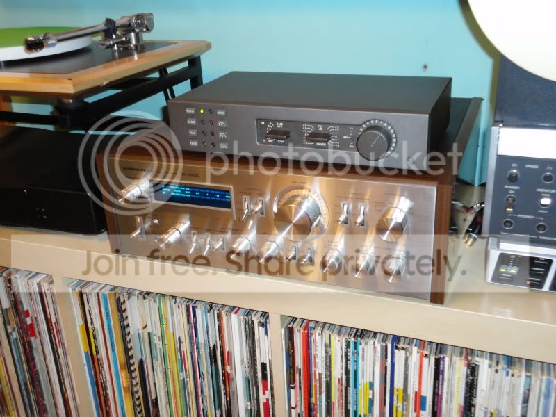

No need to worry Werner, playing fine at the moment and into the power amp section of a lovely, nearly mint Pioneer SA9800. That needed a little attention to a regulator which is why its in use. Been meaning to fix it for eight years and just got round to it!
Sounds very nice indeed but you wouldn't pair those two for the looks :)
You'd have to use ear protectors to enter the room if the volume knob of my 34 was in that position on the radio input!
