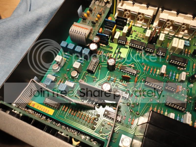

The final round up of mods is as follows.
Comments on sonics are on sighted listening only at this stage.
Some detailed technical testing with results will follow in the new year when I have time.
Quad 34
New PSU caps - made no difference so the old ones were probably perfectly fine.
New op amps (OPA134/2134) throughout - no sonic upgrade on the TL071/2 except in the phono section where noise is clearly reduced.
Low noise transistors on the phono card, solid aluminium caps in place of the tantalums and a reduction in collector current through the transistors. Worth doing - a few dB less noise - but no real sonic gain.
Maxim Cmos 4066 switches - sounds a tad cleaner and operationally these work perfectly. Be very careful with other 4066 replacements - some don't work well and upset the operation and PSU voltages.
Remove all electrolytic signal coupling caps. Lots in a 34 and all at 100uf. I'd already replaced these with Silmics but removing them all made no difference to the sound. A bit of a surprise given the quantity but there you go.
Increase output to 1.5v. Well worth doing as this allows a reduction in power amplifier sensitivity. Net noise drop of about 10dB. Easy to do and probably the one must do for anyone running this series of electronics.
Move the RIAA high pass filter down to 30Hz. One cap swap and worth doing. TTs are better behaved these days and tend not to rumble, and we don't use those daft very high compliance cartridges. Quad were right to be careful in the 70s but this can be relaxed today.

Quad 306
Super little amp and this plus the 606 are essentially a 405 with a further decade knowledge and experience thrown at them.
The 306 has a tiny case and this limited the capacity of the PSU caps. Caps have both shrunk and improved in the 20 years since the 306 was born. Increase the caps to 6.8kuf (from 4.7k) and go to 63v rating. Panasonics are excellent and good value.
Reduce the input sensitivity to 1.25v (from 375mv!)
Thats it - leave the rest alone.
The 306 uses a TL071 as a dc servo and you can decouple the rails on this if you wish.

Quad 405
Lots you can do to this one but I've done the following:
As with the 306, the 405 has a small case and can benefit from larger capacity caps of the sort not available in the mid 70s. So fit some nice 15kuf BHCs (original 10k).
Recap the main boards. Kits are available to replace all the electrolytics. The 405 runs hot and is unventilated so definitely do this.
Reduce the input sensitivity to 1.5v. Do it - 405s are a bit hissy but not after this mod.
OP amp upgrade. An OPA134 in place of the TL071 reduced overall noise by a couple of dB but doesn't alter the sound. Given the op amps are cheap you should definitely do it, just don't expect a sonic lift as the TL is more than capable in this circuit. Johnson noise dominates in this circuit so without the sensitivity reduction, a couple of dB is the best you'll get. Don't fit ultra low noise or high speed devices as you will gain absolutely nothing.
OP amp decoupling. Worth doing though I confess to struggling to hear the benefit. Compulsory if you ignore the above and fit super-fast devices.
Should be better in theory so nothing to lose in view of the cost.
Both the 405 and the 306 would benefit from some case ventilation IMO. This is something I'll work on in the new year when I can source some spare case parts.
Happy to give part numbers and more detailed instruction but little here is new - its all out there so have a browse.
