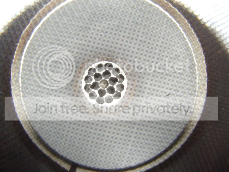

Mine are different again:
(blurred black dots are the dust cap)
The TW on the 10" is quite different to the 12 and 15" it seems.
Still has a bullet shaped centre tho' :), although maybe not so pointy.

This is an early version of the waveguide that was first used in the DTM8 (desk top monitor) and the DC1000/2000/3000's when Tannoy moved to separate LF/HF magnet assemblies.
The later range where they all use the Tulip waveguide is shown here http://www.hilberink.nl/codehans/tannoy29.htm
The TW is certainly very different. It must be to match the drive unit size.
