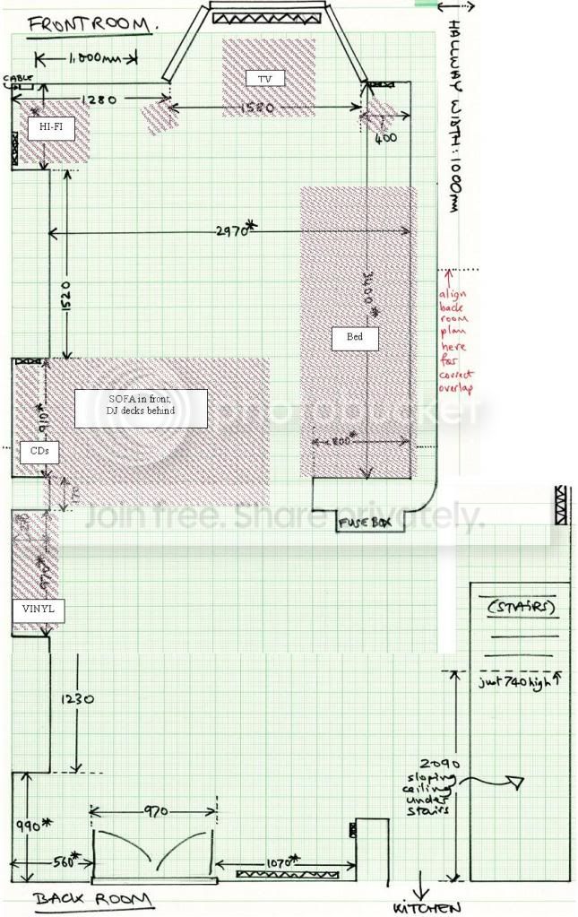

Here's plan of my room, if it's of any use.
The speaker at the top right is now further from the corner.
The bed is less long than it appears.
There's an unmarked 30cm 'beam' across the roof connecting the bit of wall with the fuse box to the bit of wall opposite.
We've also now got PC, table, chairs, CD storage, etc in the bottom half of the room. (It's quite a full room).

I would like another opinion from someone but maybe ur room is way to long and speakers are struggling to fill it and alot of boom is collecting at the rear of the room, what type of walls and floor do u have also?
It's a wooden floor. The walls are old stone walls - pretty solid.
I don't think the speakers are too small for the room. If anything, the opposite imo. They certainly look big in the front room!
It's hard to say though, as the room is kind of massive, but in lots of different sections. There are no boundaries, so sound flows into the kitchen, and up the stairs. It can also sound boomy in the semi-enclosed front section.

your speakers would have difficulty to be in much worse places, sonically.
One is stuffed in a corner (with all the room gain that provides, the other is not - complete anomoly), there is a bay window causing undoubted havoc, soft reflections on one side up to a certain height (bed) and nothing on the other.
Those JBL speakers I put a link to would be perfect.
Spending thousands and putting the stuff where you have it now, well I think you will continue with the room problems, just with some frequencies marginally improved.
You need some serious eq going on if you're to have a hope - those JBLs , or perhaps a behringer deq

I think as the everone has already said that the room is quite conjusted and in the arranging all the stuff together will make more complex. It would be better to have some best place.
I have to admit that when working out hot to ram things in, the only sonic consideration was to have the speakers pointing in the right direction for everything (which was more difficult than you'd expect).
The speaker that was in the corner is now not (so much), but has a different anomaly of being in front of the start of the bay while the other is a bit further from the bay than shown.
One problem I'm worried about with using electronic correction is that the problems seem really variable depending upon where you are in the room. If they correct for one spot it could just make things worse elsewhere?
Am I just doomed? I don't think I can do much rearranging without surrendering some fairly important practical considerations. Save me!
Hmm... most of our listening probably take place in bed - but that tends to be more relaxed listening. It also a bit of a strange position, so might require some extreme eq-ing?
I listen to quite a lot of music from behind my decks. I'm often feeling rather ill, but when well enough I like to be able to move about a bit while listening - this is my favourite way of listening to music. One of the advantages of the Dalis was that they sounded good in lots of different positions.

I think that you're right - room correction is done at the point of the measurement mic, which is where you're sat most often.
However the 'bad room position sound' would still be better than it is now, which is of course all over the place throughout the room.
If you just dont want to go this route at all, consider speakers designed for wall placement.
They are out there, like Audionote for example. At least then you are using a near wall position with a speaker designed to be used this way..
